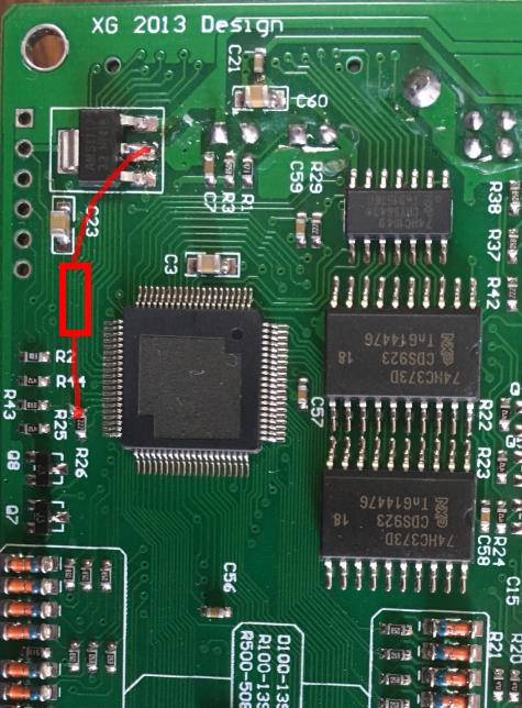

  • Reset Programmer to Old Software Version
    if the programmer is bricked. you can add a resistor(about 240 ohm) as the follow picture. and install old version software , then reflash firmware. then remove this resistor.
